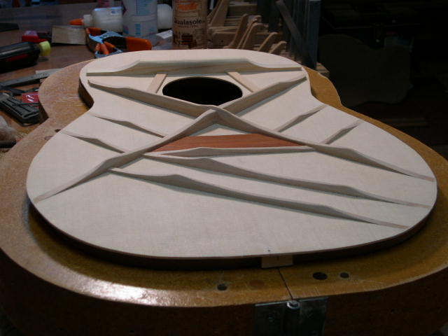

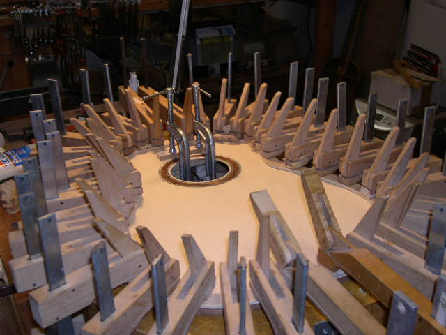

As threatened, here's a few more pics of the Tasmanian Tiger Myrtle SJ. First is a shot of the bracing pattern. The lighting is such that you can get a feel for the contours:

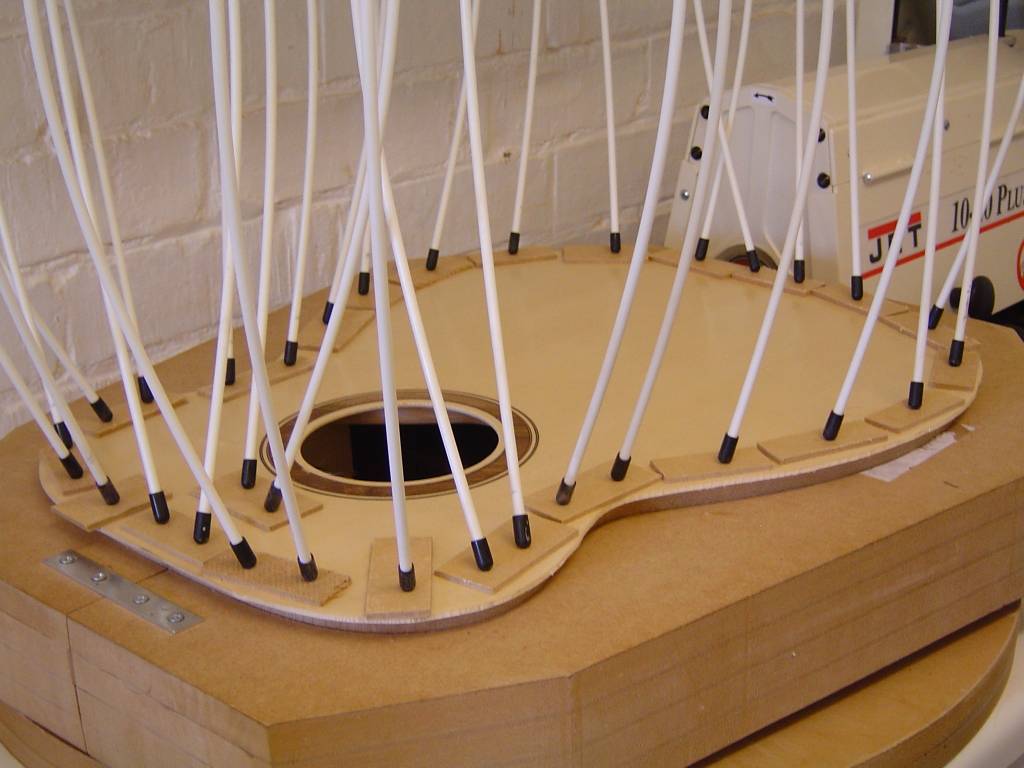

Next, gluing on the top...
Routing for the tail wedge:

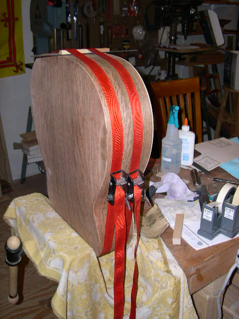

Gluing in tail inlay w/ band clamps:

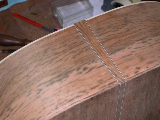

Wedge installed-- it is also Tiger Myrtle, as will be the bindings and back strap:
Thanks for looking, and thanks again to Tim Spittle for such a fine material to work with.

Very cool Steve! I like the band clamps fot the wedge. Learn more every day. That box is going to be beautiful.

NIce work Steve, always interesting to see another's methodology. Very neat transition from the tail wedge to the back strip. I believe that the potential of the Aussie woods is only just being tapped, interesting to hear how this one sounds. I assume this is a sitka top?

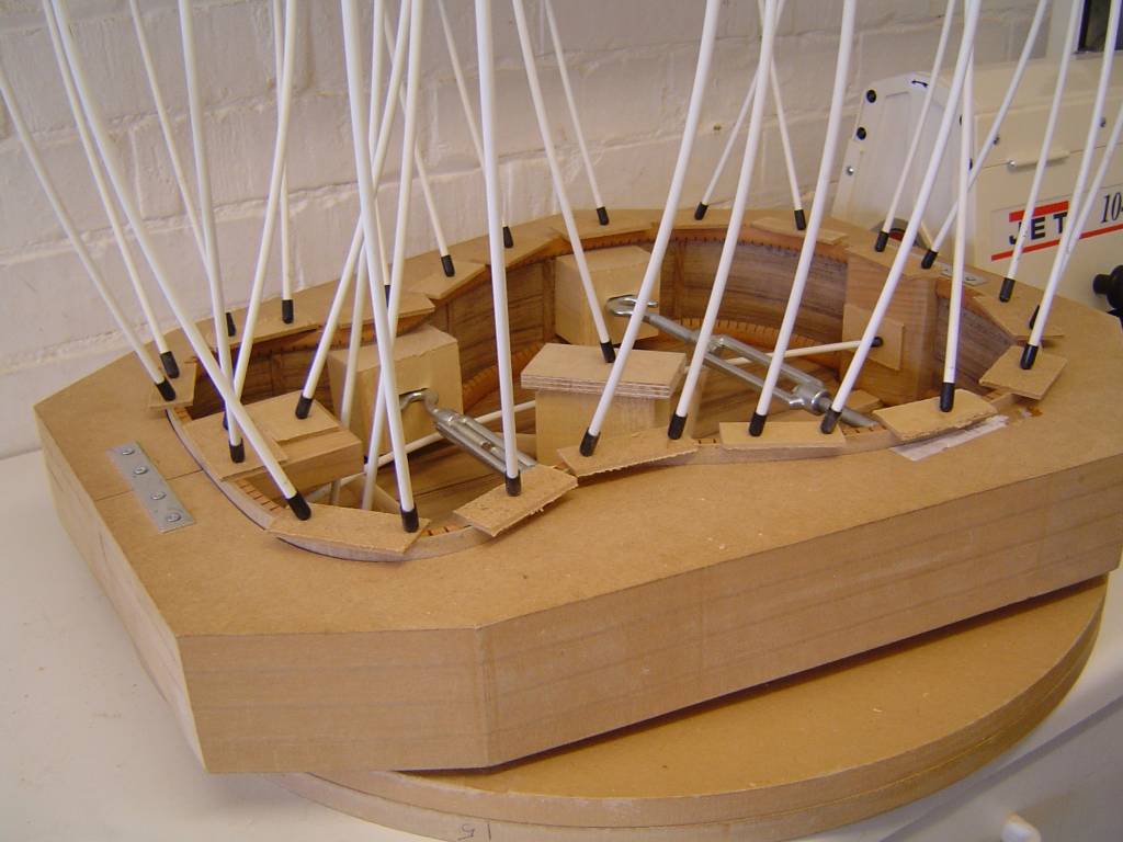

One thing though, do you think you've got enough cam clamps? I glue my plates on with the go-bar deck and find it much quicker than my old clamping method.

I’m curious though, to what the “C” clamps are being used for in the sound hole?
Also, I like that, you use a caul between your clamps and top. What material is it made of?
Looks like it could be made of 1/4" ply. Can’t really tell.

Colin--thanks, mate. I hope you are sitting down, so that when I say NO, this isn't Sitka, you won't feel too light-headed. This is some of Shane's famous Lutz, and I can tell you this is some promising tonewood. What a tap it's got! I'm really anxious to hear what it sounds like w/ strings attached.
And yes, I'm a bit concerned about the number of cam clamps myself. I've got them spaced as close as they will go, but still worry about insufficient pressure.
PostPosted: Wed May 30, 2007 9:37 pm
Robert, we were typing at the same time.
Thanks for your kind words!
Now--the "C" clamps are clamping the top to the "L" part of the head block.
And yes, that caul is a 1/4" donut of plywood.
There is one on the underside as well, that is not shown in the pic.
I like the idea of spreading out the pressure evenly,
as well protecting the fragile wood.

Very very COOL Steve . I like every thing I see in the pics . The Tiger trim is a real winner with that purfling .Your workmanship looks immaculate !
The bracing has my vote also.

I have always been curious how one would use a gobar deck to attach the tops and backs to a guitar and I now know. Does this take shorter bars or are all of the bars the same length?  Also, how do you go about keeping the top from slipping on the glue when you apply pressure? It seems that since the gobar is bent to apply the pressure, the top would want to slip in the direction of the bend??

Ken, Hesh is basically correct. (Did I just type that?! ) But if you are like me, glue a little block of spruce, or what ever you like, at the neck zone and tail area right at centerline, flush with the linings. Drill a small hole through the excess top or back material into the block and use that for your register. (The drill bit works just fine for this.) This helps if your brace sockets aren't Lance Kragenbrink-tight. Be sure to keep those small holes outside the guitar's outline, or else you will have to use wider purfling that you first planned.

Steve I learned something here I think? Did you cut for bindings before adding the tail wedge with purfling?
That gets the guitar ready for side purflings correct?
PostPosted: Thu May 31, 2007 10:59 am
Dave, come on down. And bring lots of those little slips of green paper.
Bruce, no, the binding ledges have not been cut at this stage. I like to cut over the tail wedge for the bindings...less chance of blow-out, and it makes the cut of the wedge nice 'n clean.

Robert, like you point out, if that "L" shaped headblock seems ingenious, be sure I didn't think of it. It's been done before, by many others. My approach is to do a two-part block. The horizontal piece is both glued and screwed into place (for long term stability) onto the vertical block. Now, my brother has a clever approach. He will bend, and laminate, several layers of thin wood into the "L" shape. It is material-efficient, strong AND stable. Something like this:

That block was a lot of trouble to make. I now do a finger joint between the two legs of the "L".
